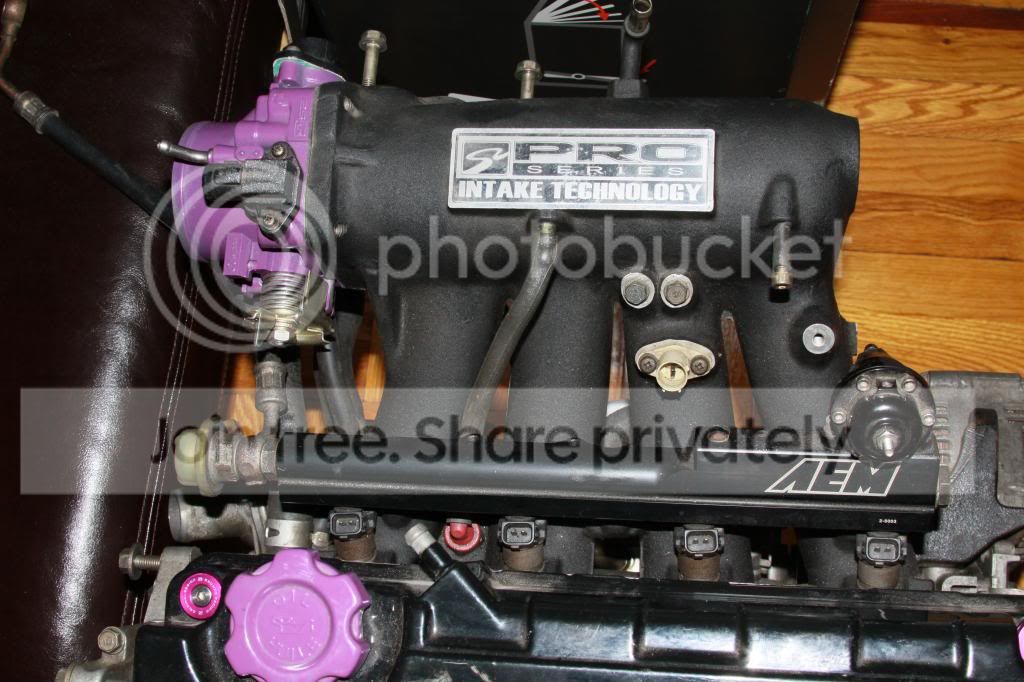

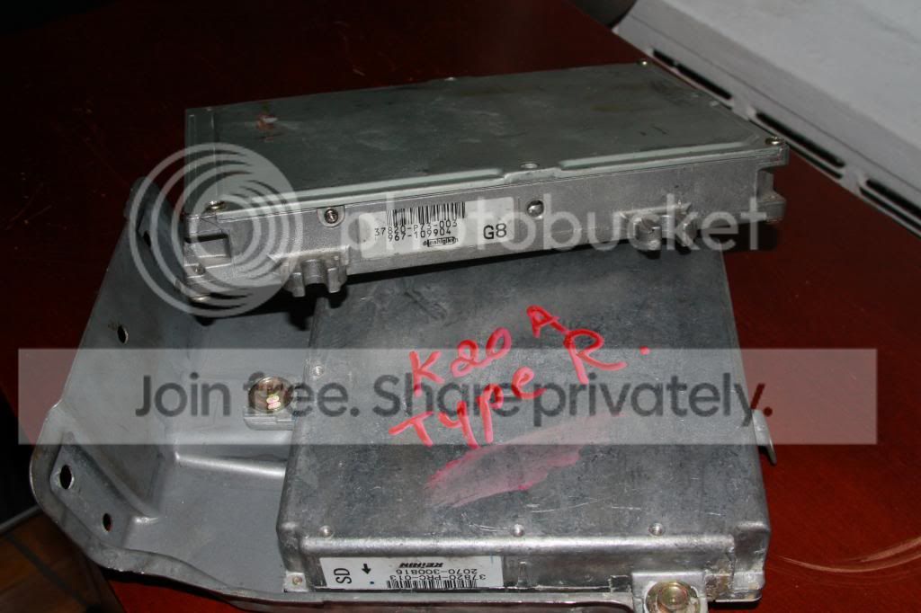

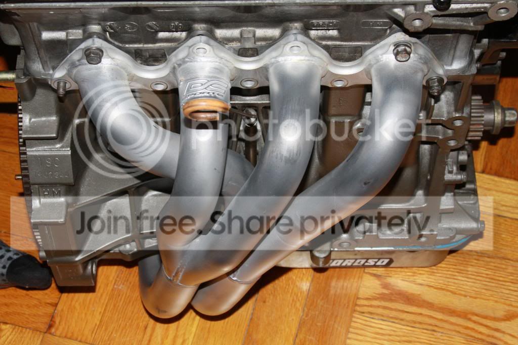

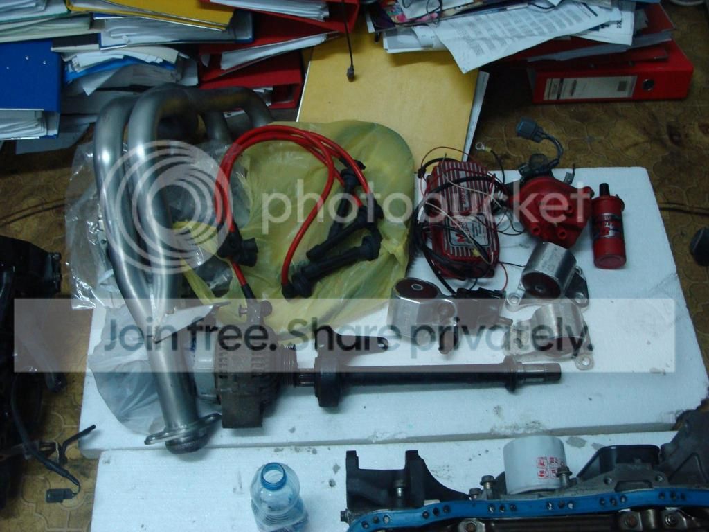

B18C Integra Type R
ECU
DC SPORT 4-2-1 Ceramic Coated

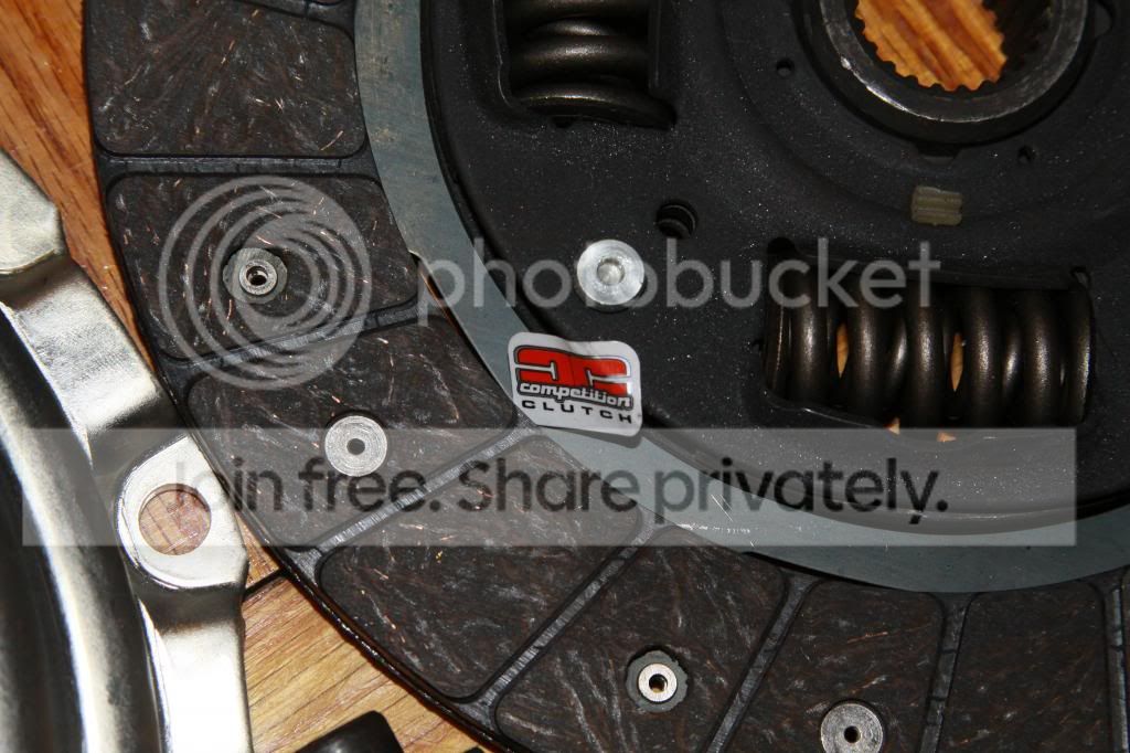

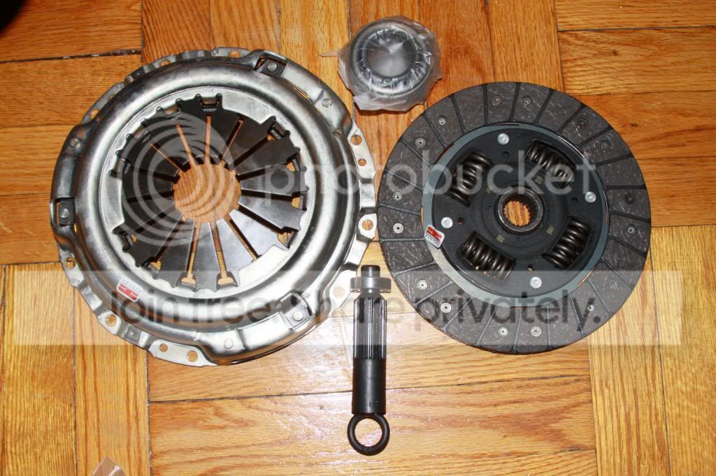

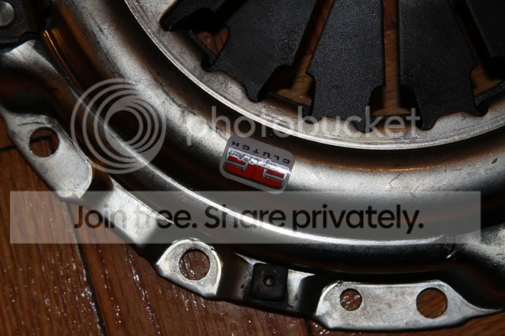

Competition Clutch Stage 2

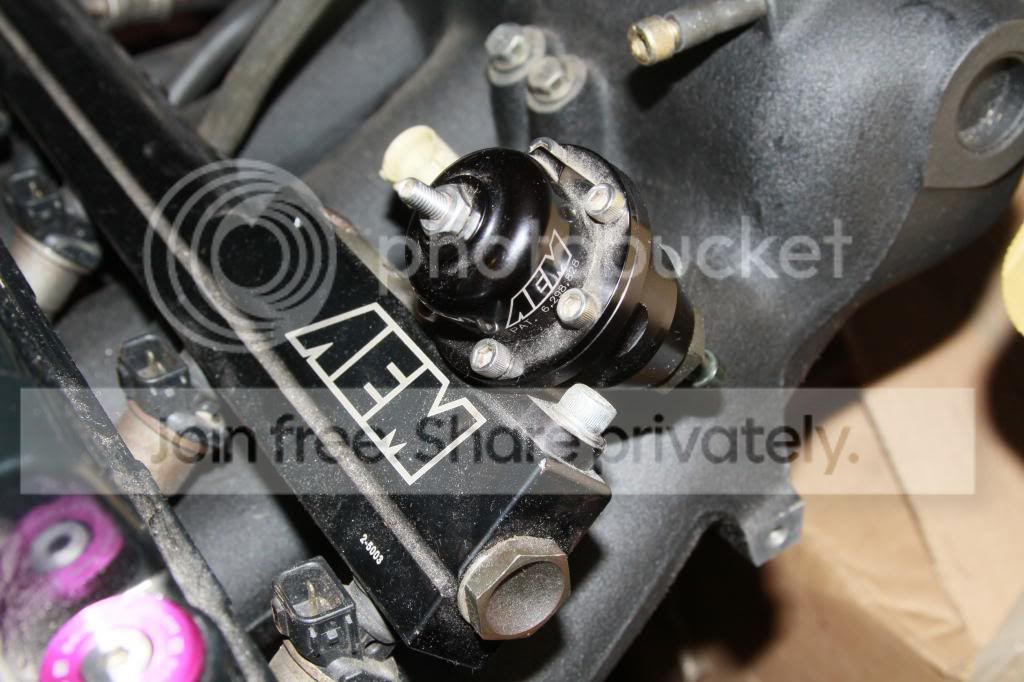

Aem Fuel Rail + Aem Fuel Regulator
MSD Ignition+MSD Distributor+10mm Cables
Lightweight flywheel
Vtec Cam Sel Password JDM
SKUNK2
Skunk2 70mm Throttle Body
Skunk2 Pro Series Intake Manifold + Aem Fuel Rail
Skunk2 Alpha Series Adjustable Cam Gears
Moroso Oip Pan 4.5L
Pr3 Type R Head
Innovative Motor Mounts

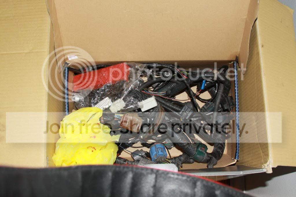

Wiring Loom with OBD-2 to OBD-1 converter

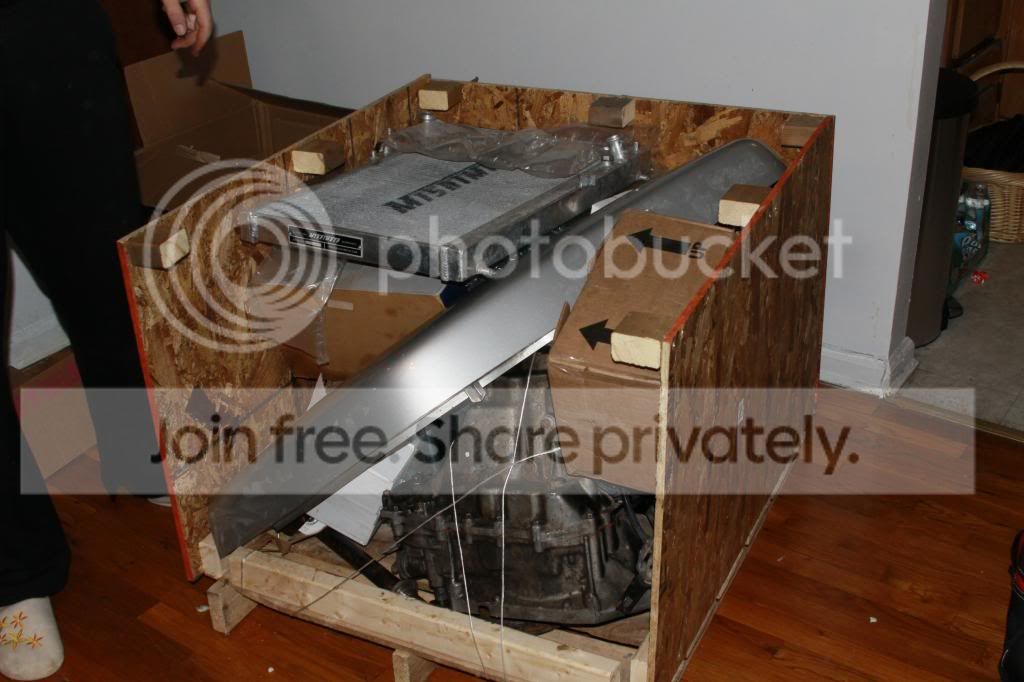

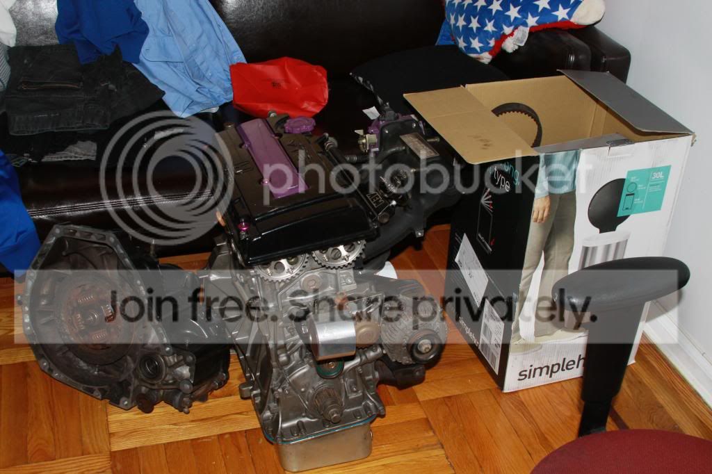

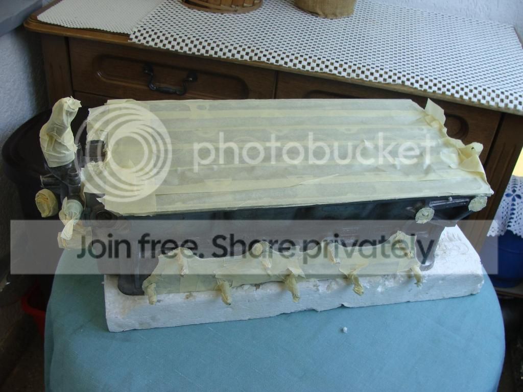

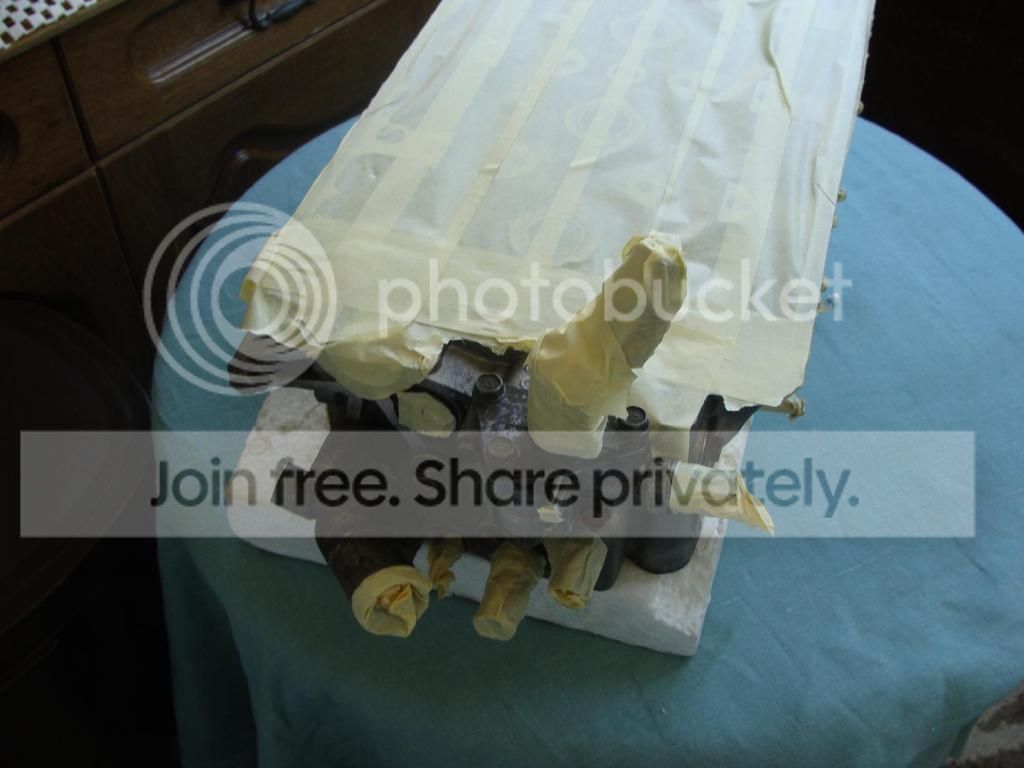

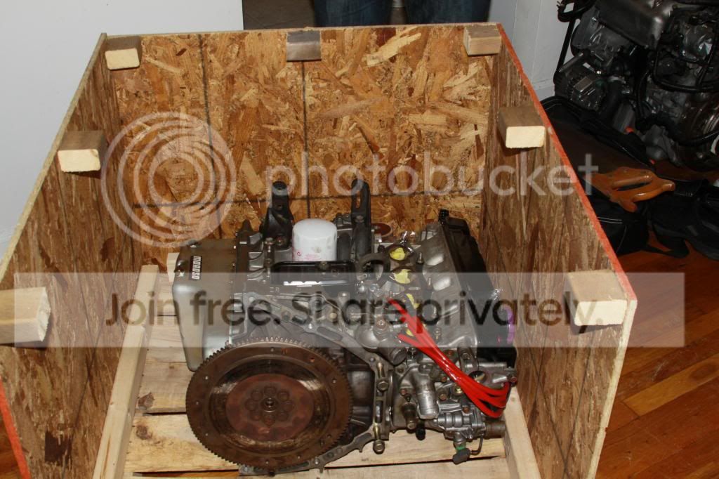

This are photo when i made a box for shipping
Toto jsou fotografie, kdy jsem udělal pole k odeslání

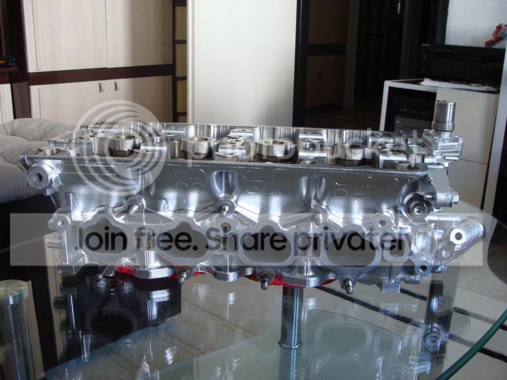

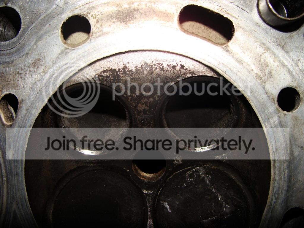

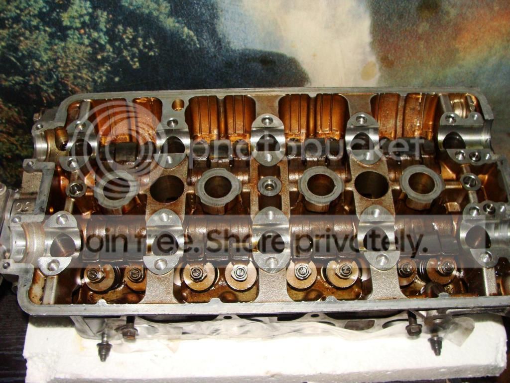

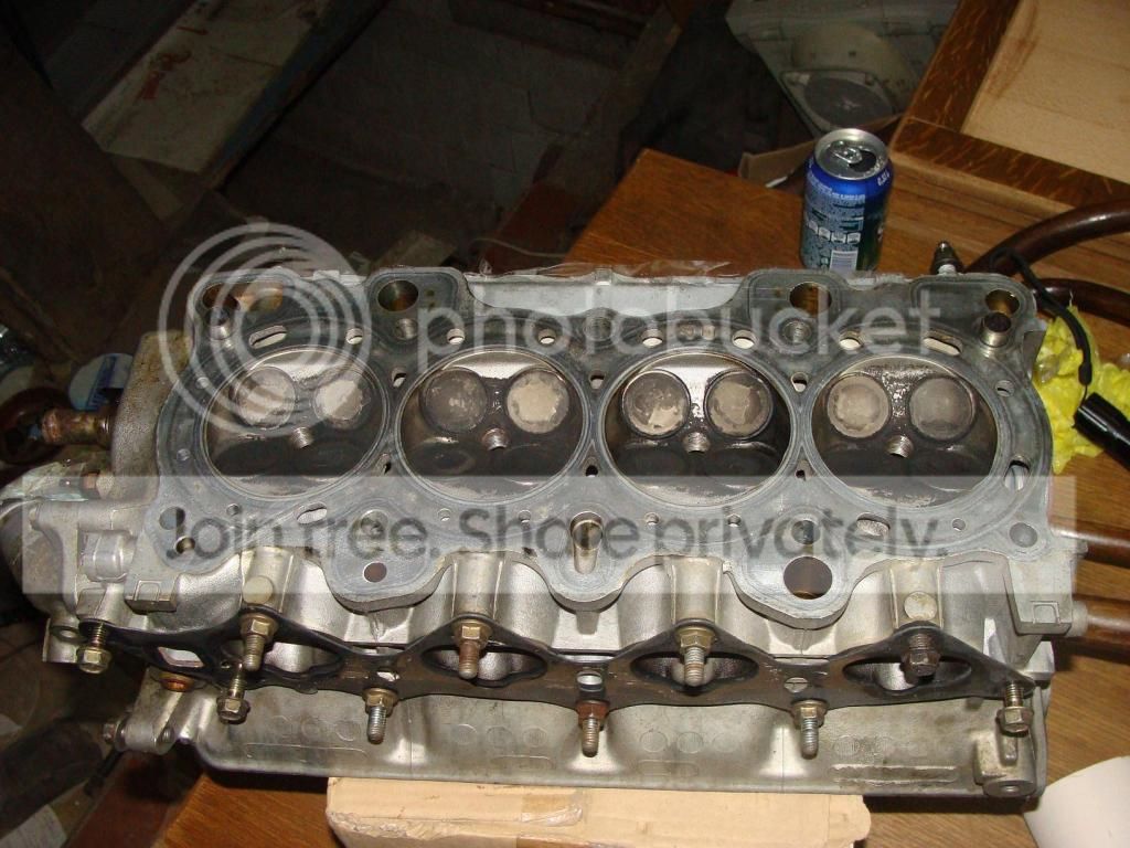

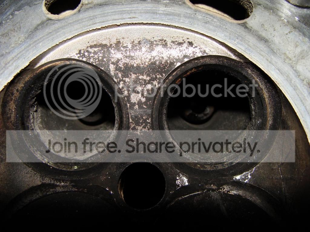

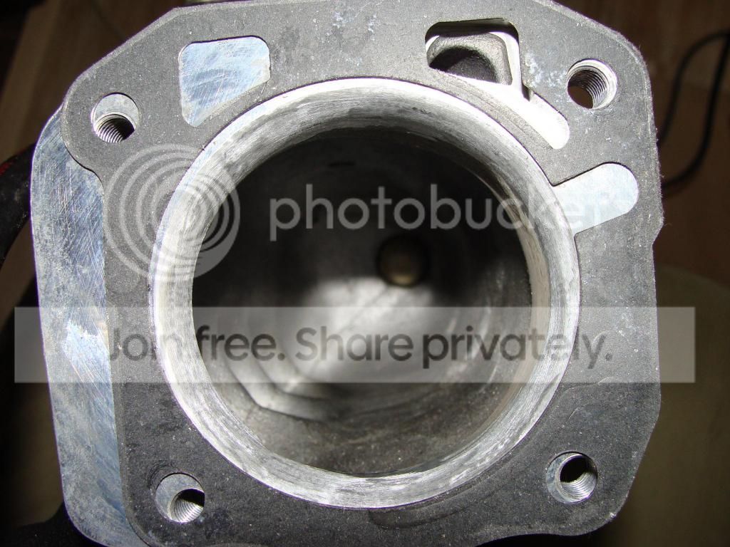

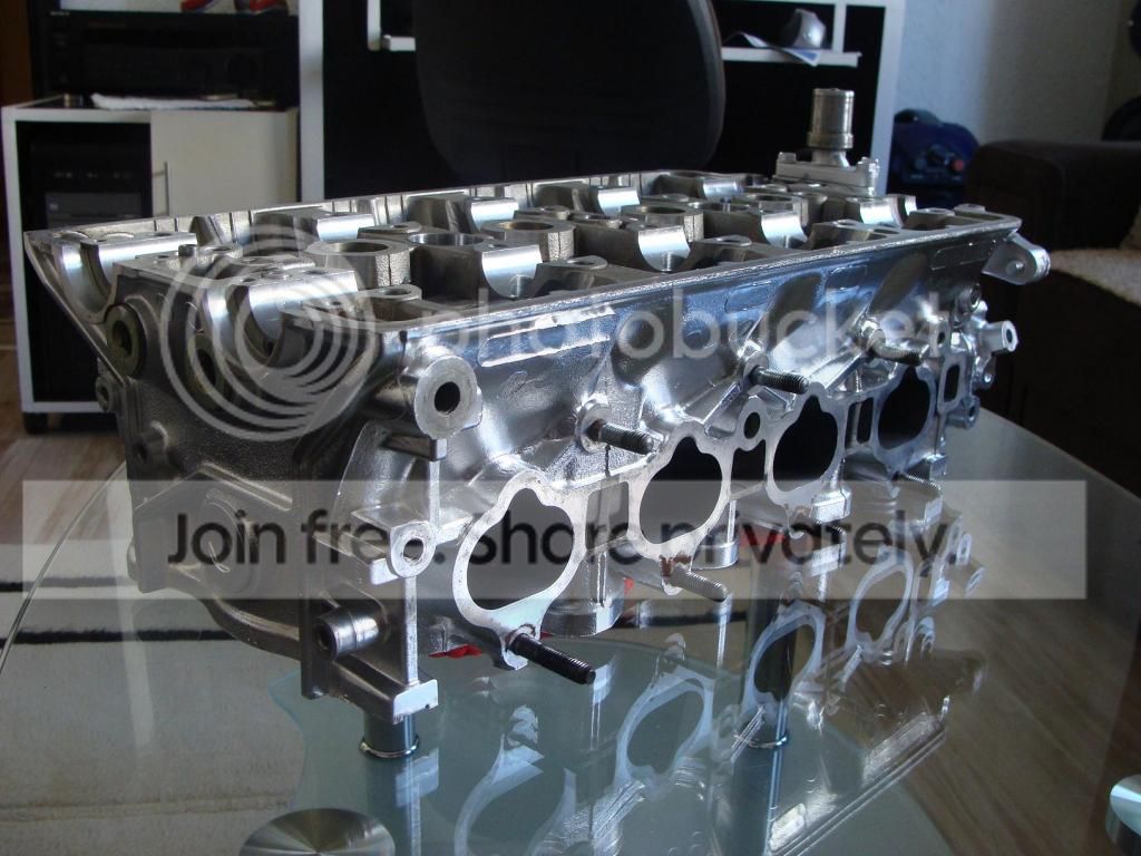

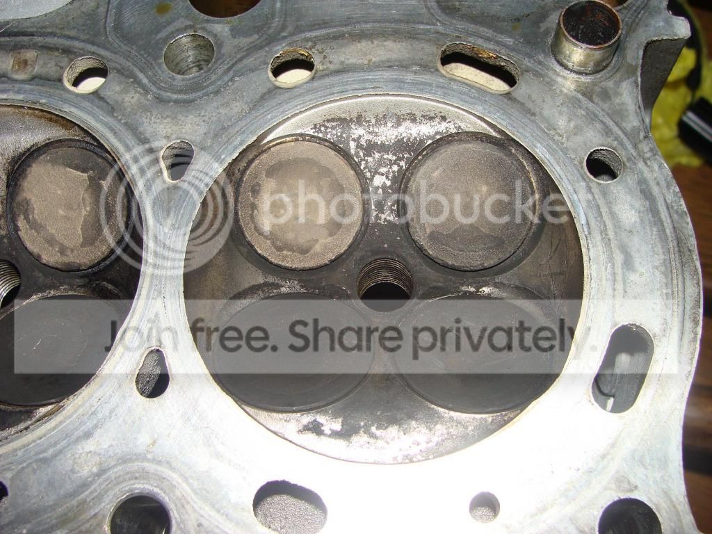

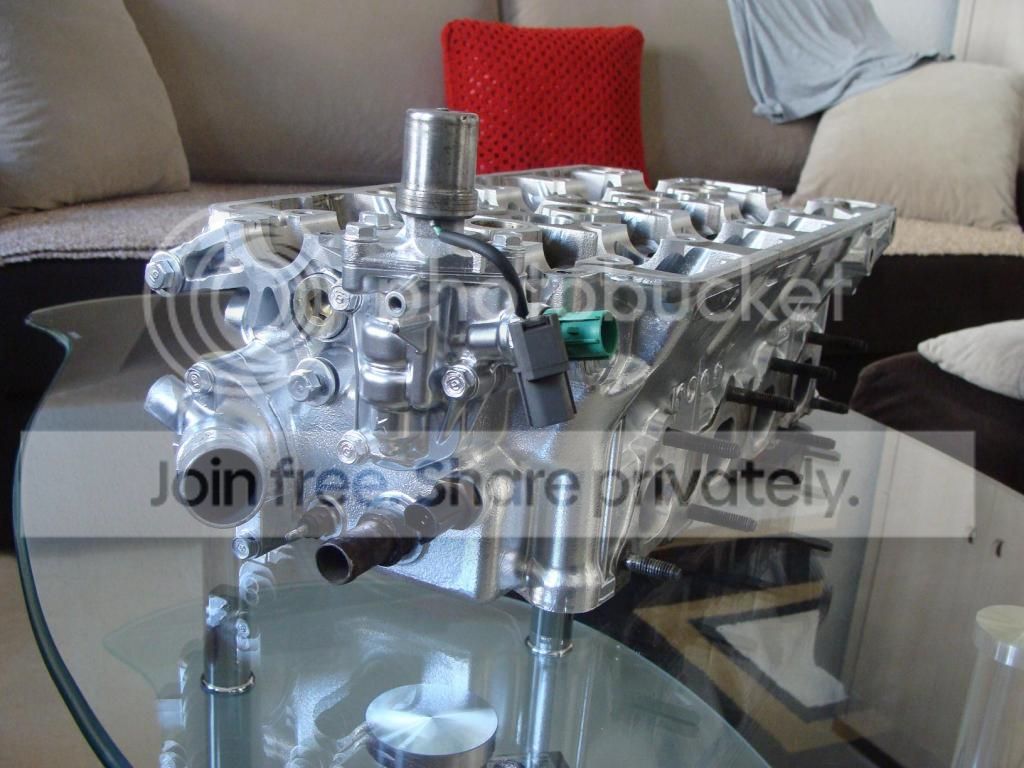

Here is the head job done by me
When i open the head it was in this condition
Also i bought ARP head Studs
Zde je úkol mě hlava
Když otevřu hlavu to bylo v tomto stavu
Také jsem si koupil ARP hlavy Studs Doprava

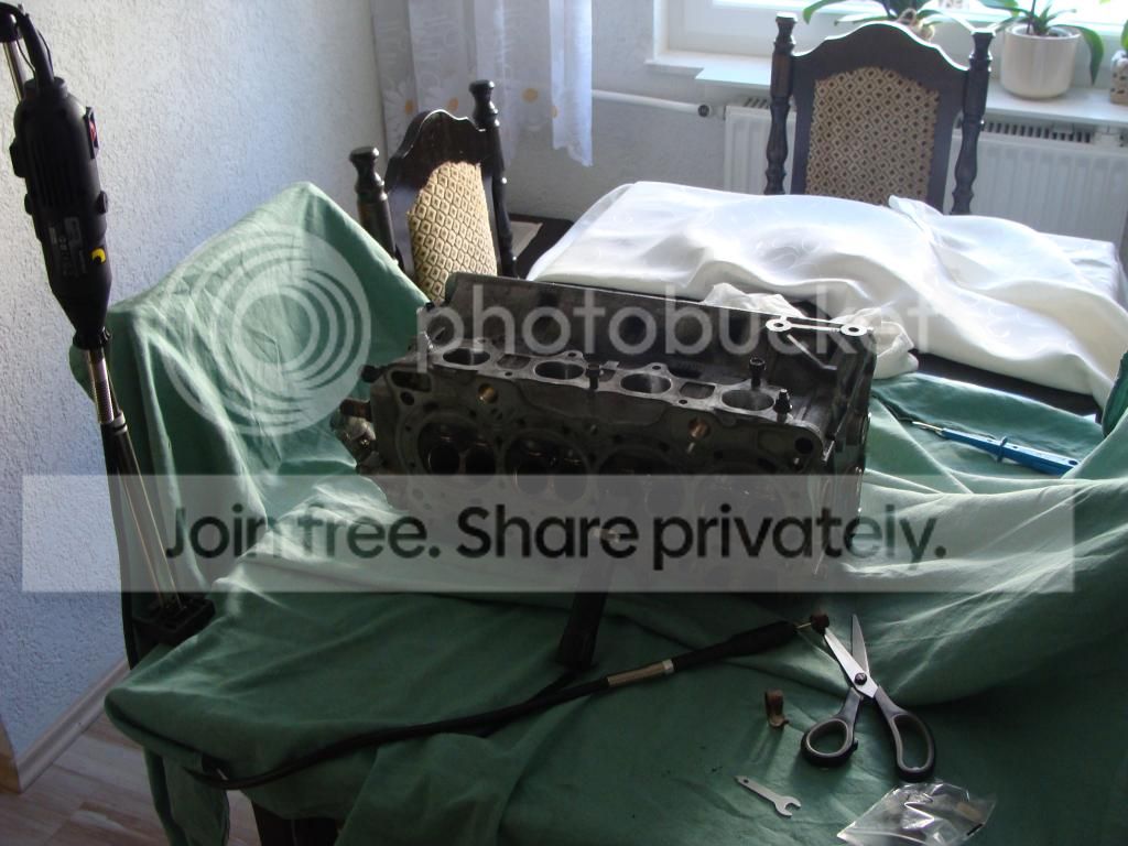

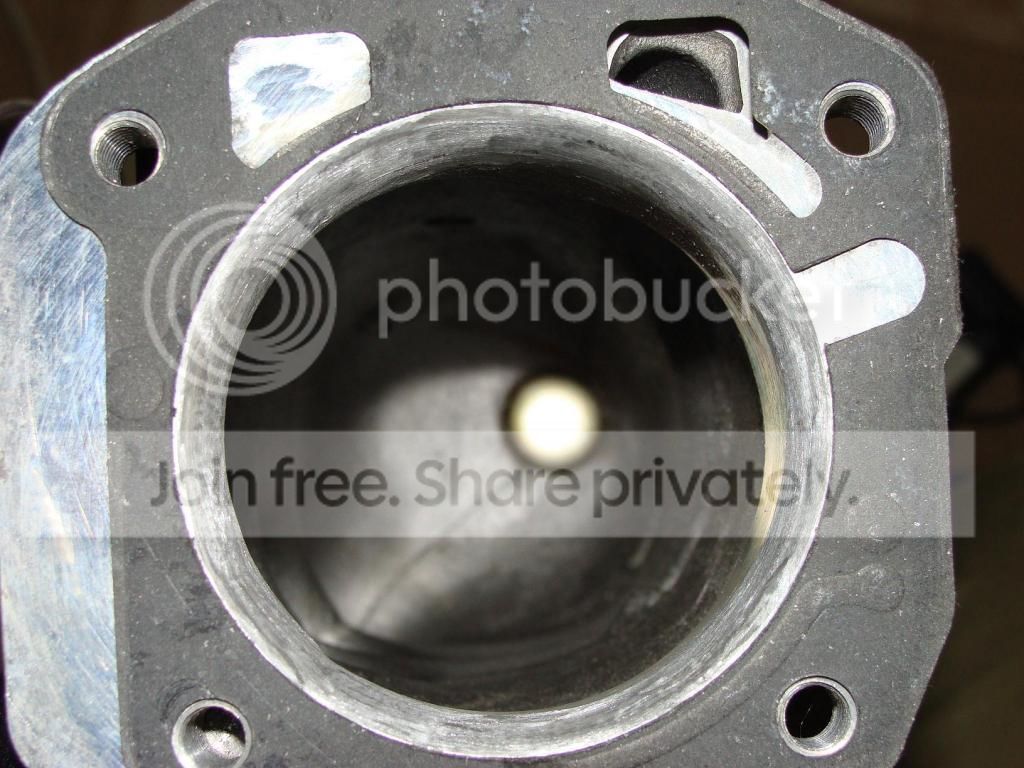

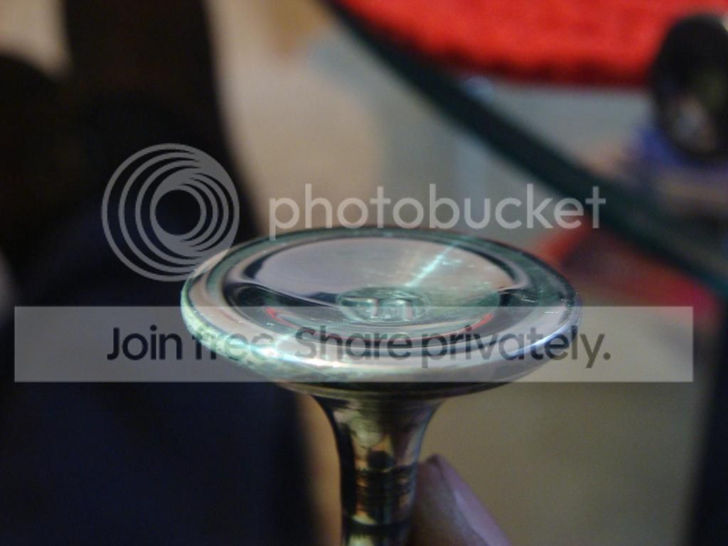

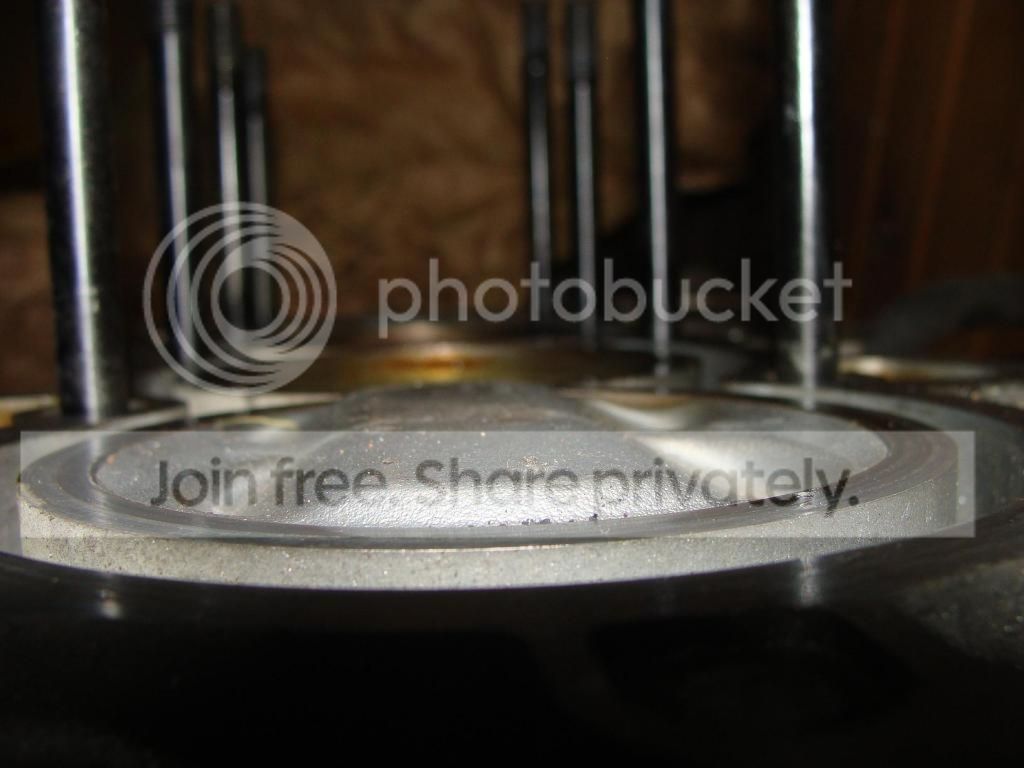

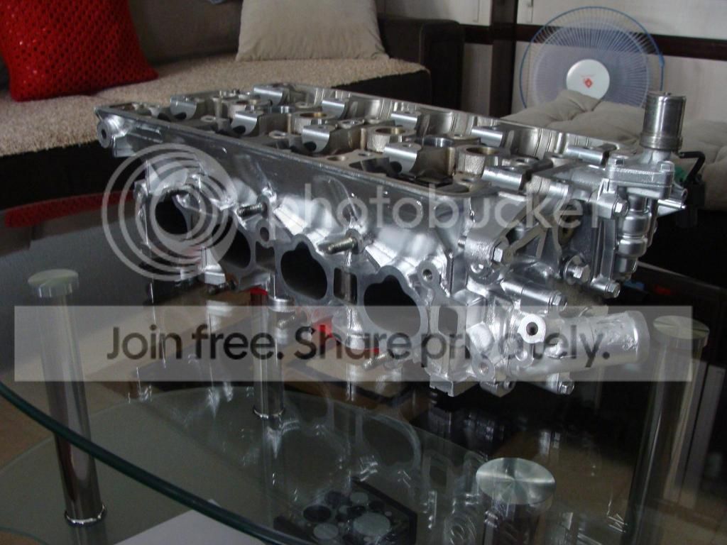

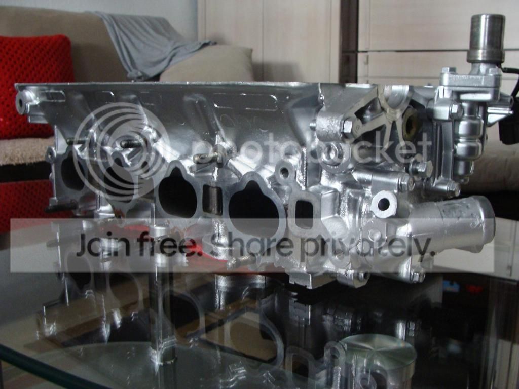

good job on the head. polished ports looks very clean. how you did it? with dremel?
anyway interesting project. iam will keep an eye on it Mrk
Příspěvky: 2887 H+ body: 4
ge.nnc je teď offline  ge.nnc
PříspěvekZaslal: 5.9.2014 , 17:47   Citovat
83427 napsal:
yes i use dremel and sandpaper from 240-2000 water sandpaper
i worked for 2 weeks day by day 1-2 hour in day
I not supposed to finish work quickly, because if you work more than 1-2 hours a day,
will get tired from sanding and nerves will begin
and you will start to finish job as soon as possible

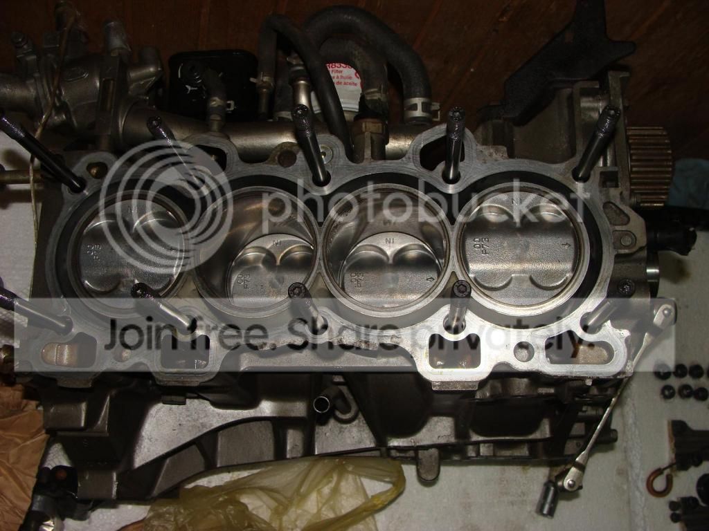

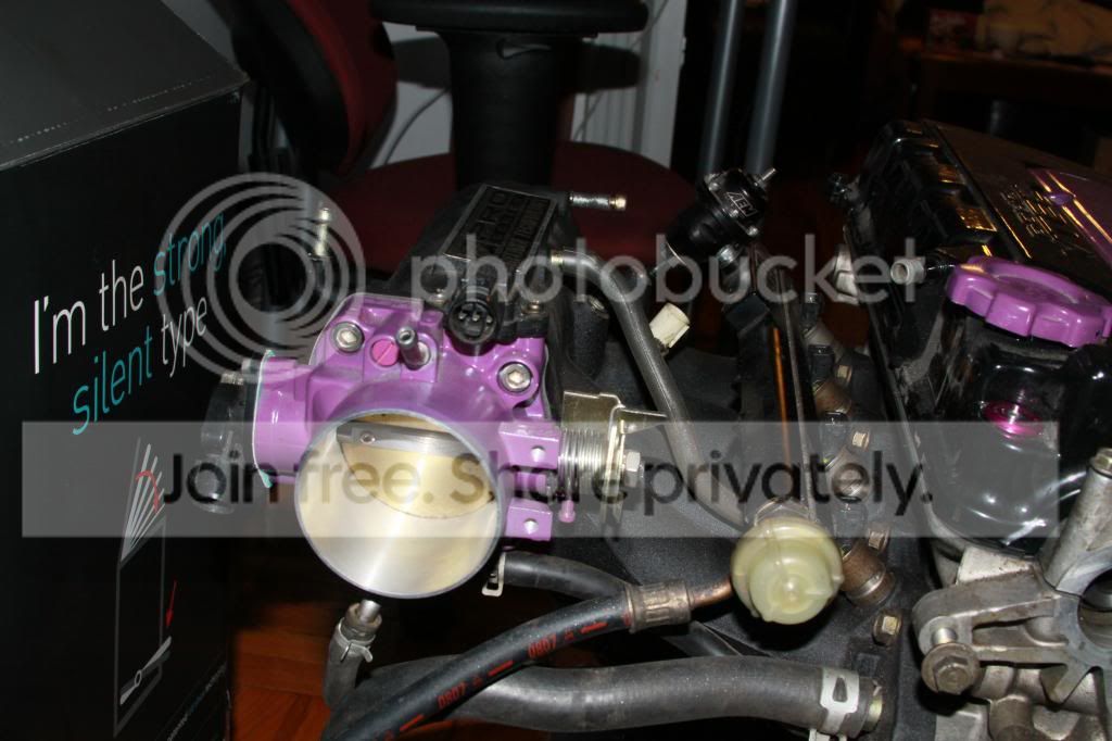

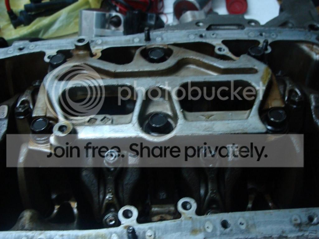

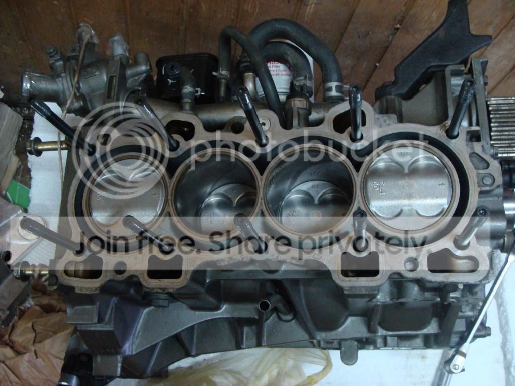

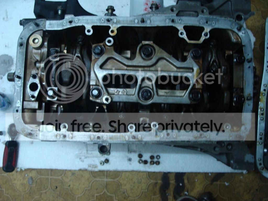

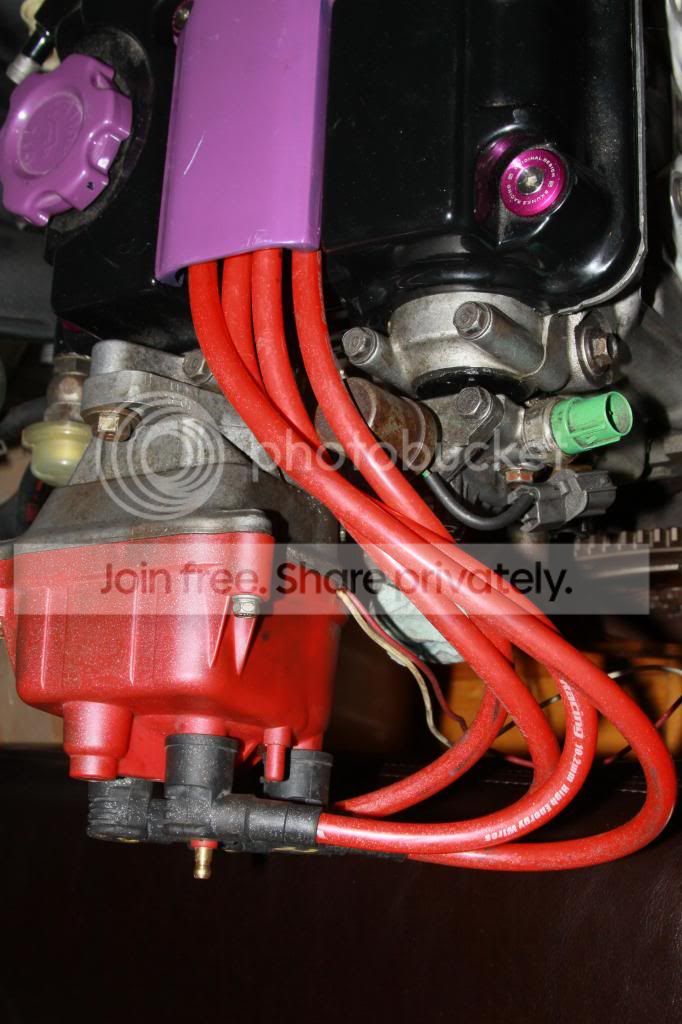

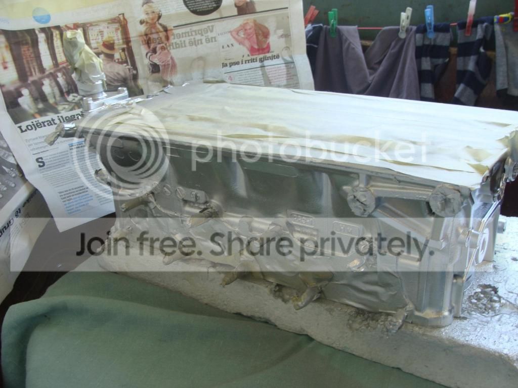

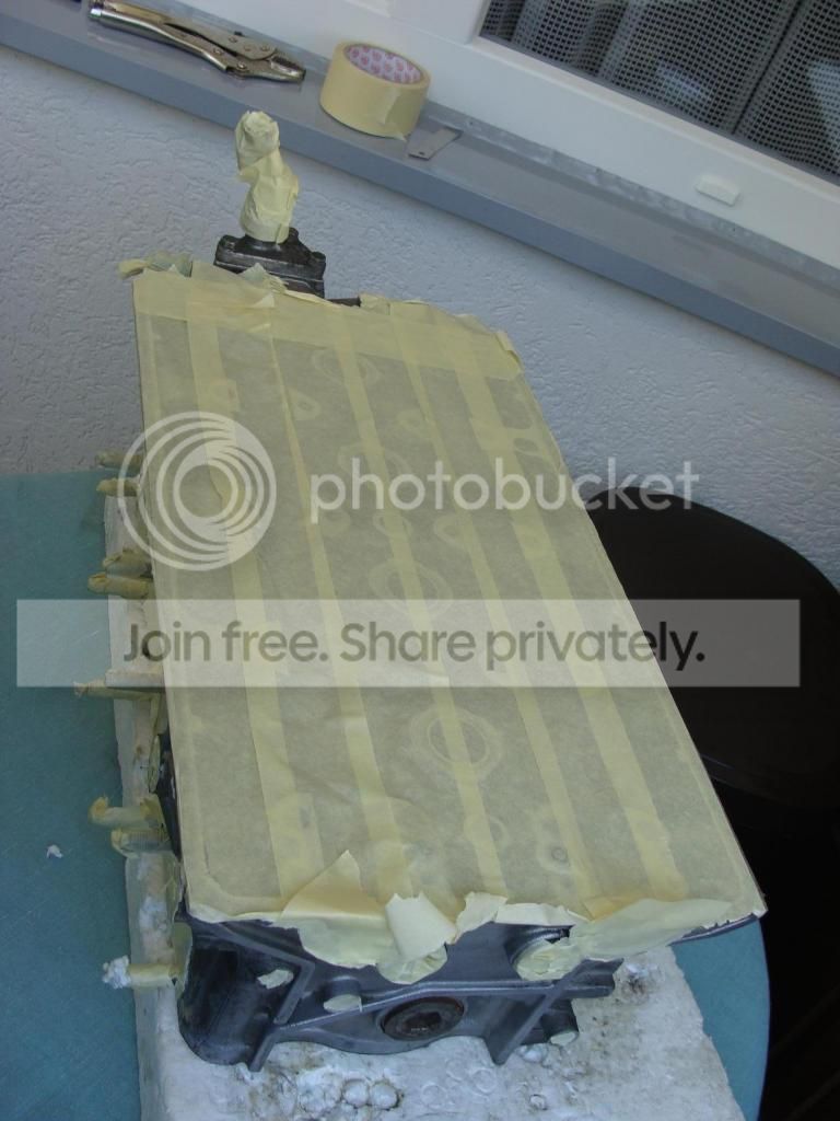

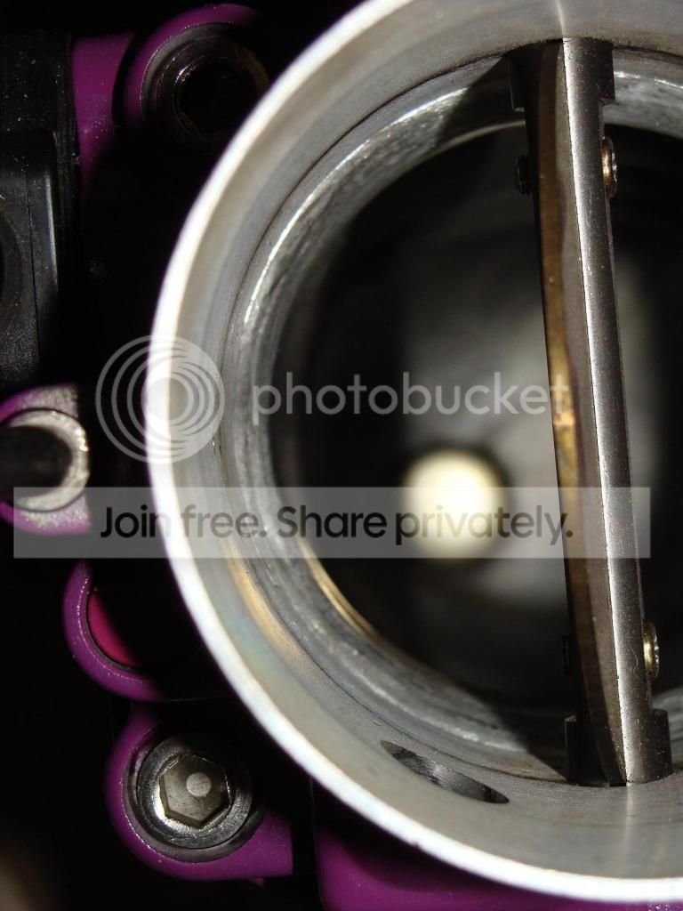

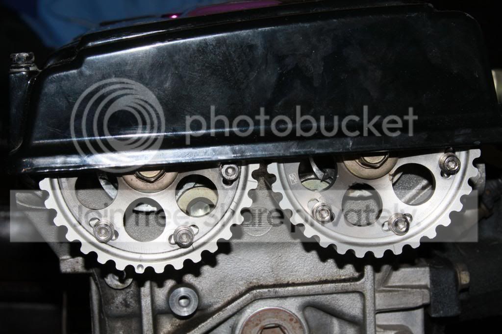

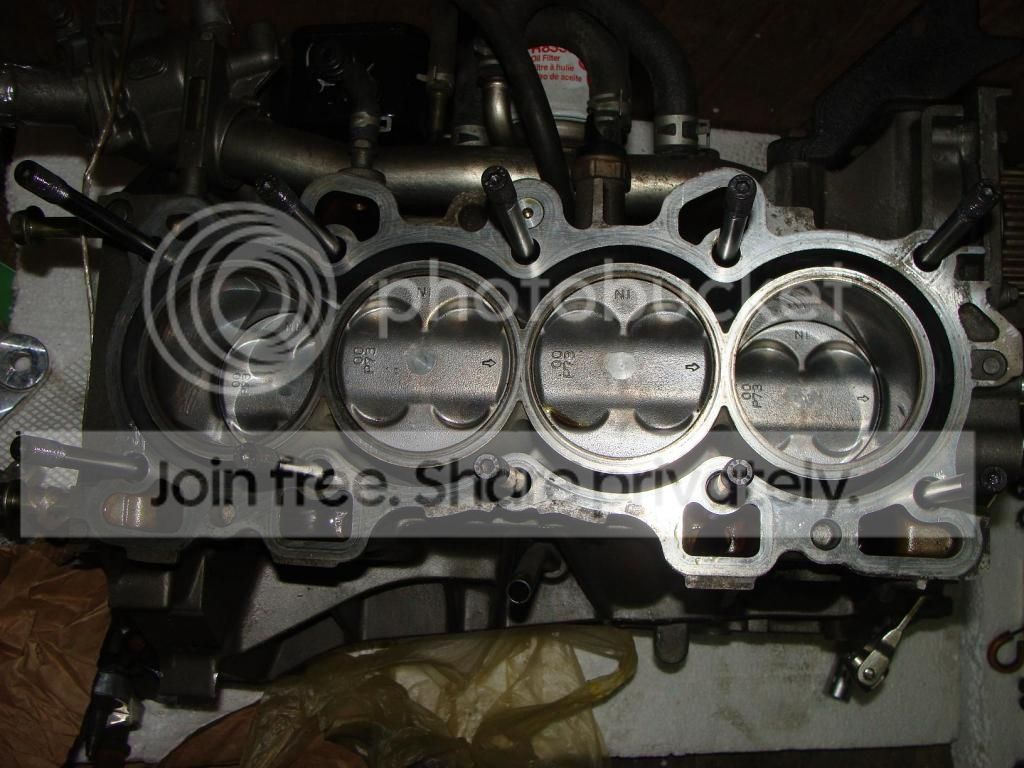

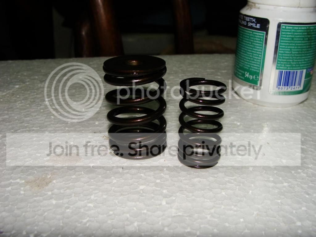

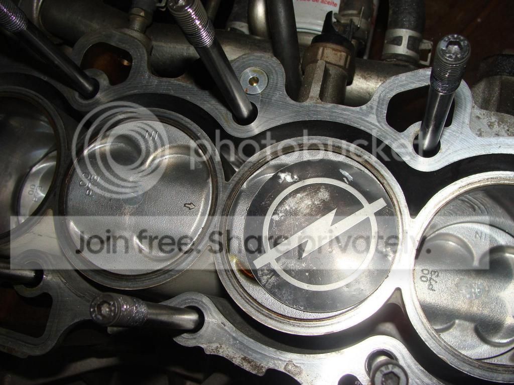

Here are some photos during the work

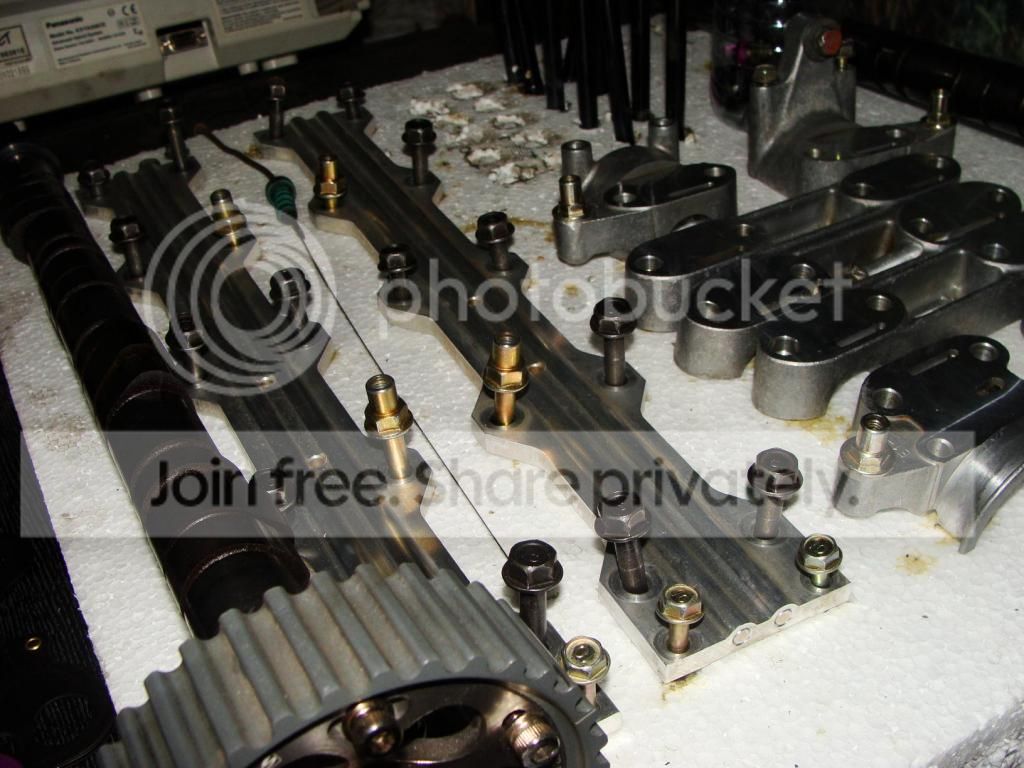

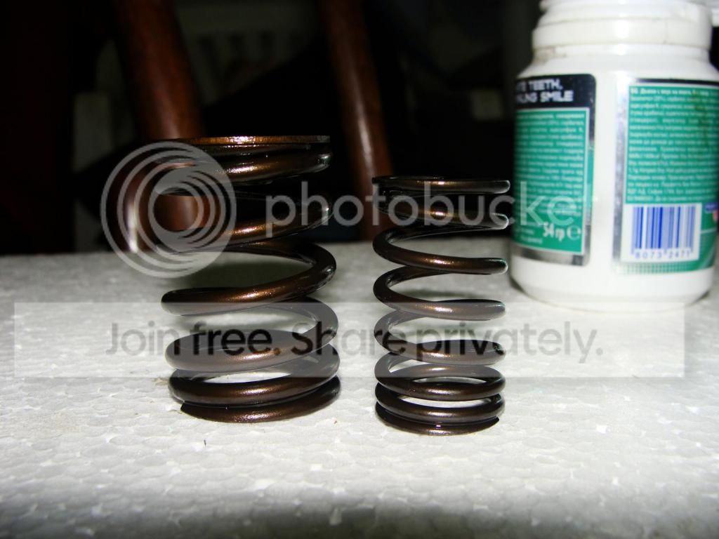

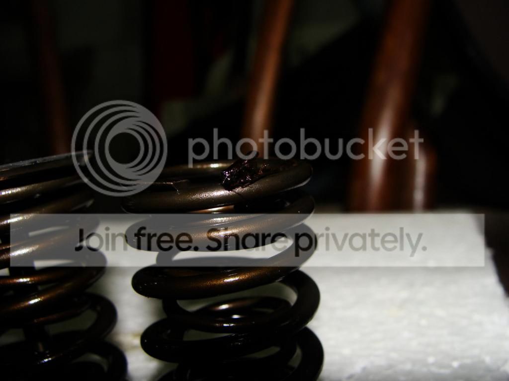

Dual Valve Springs

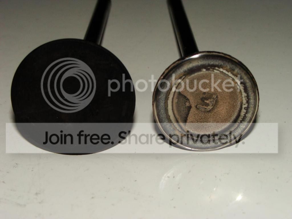

Look what i found inside valve springs
Working into head with dremel

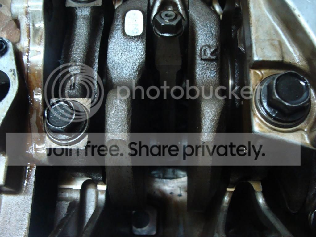

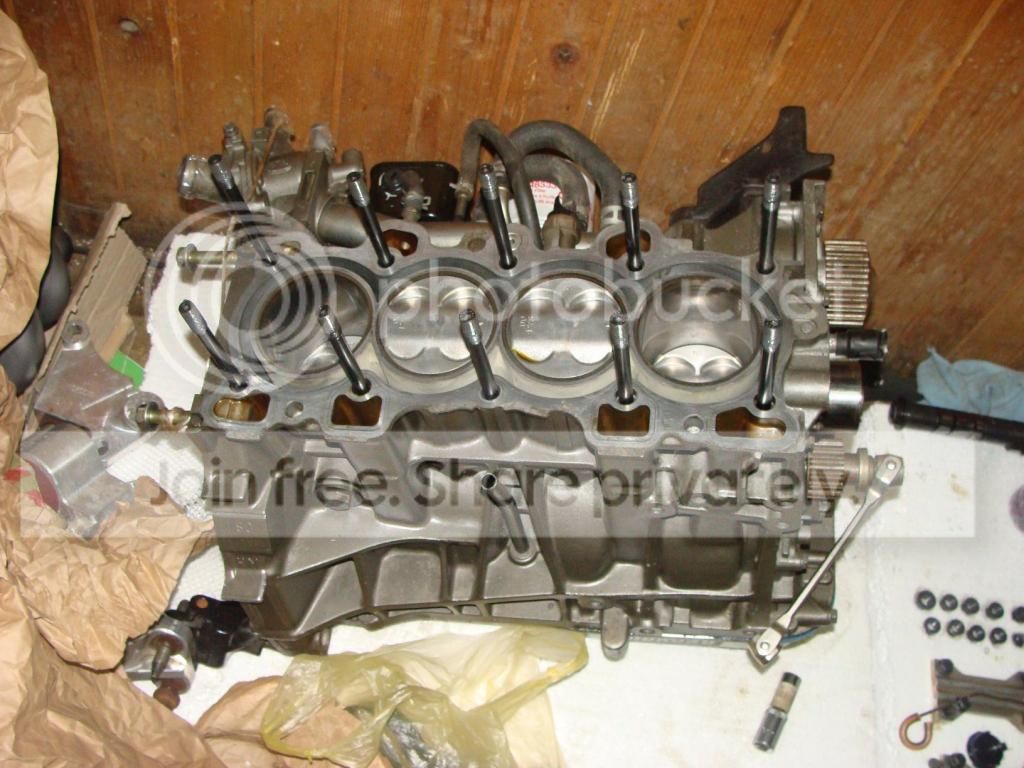

B18c block with arp head studs

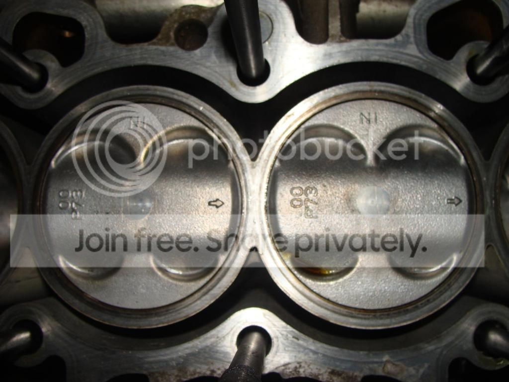

P73 00 ITR SPEC R pistons 11.1 compresion ratio
Opel haters

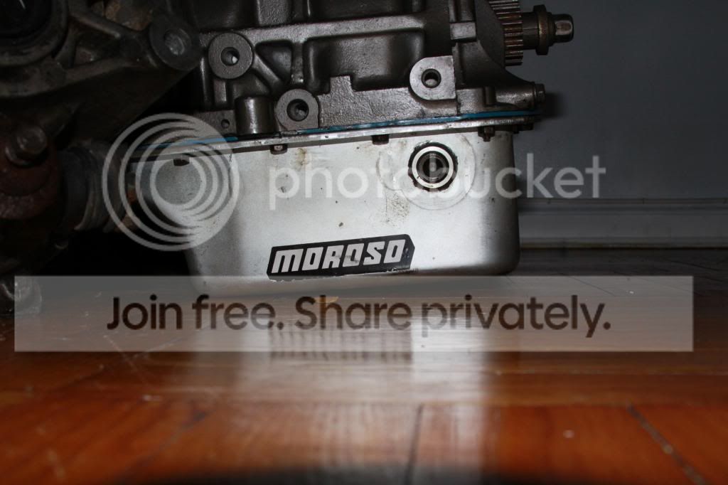

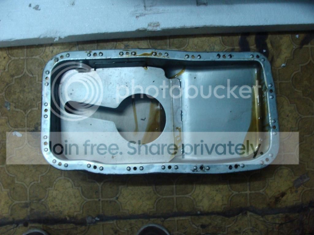

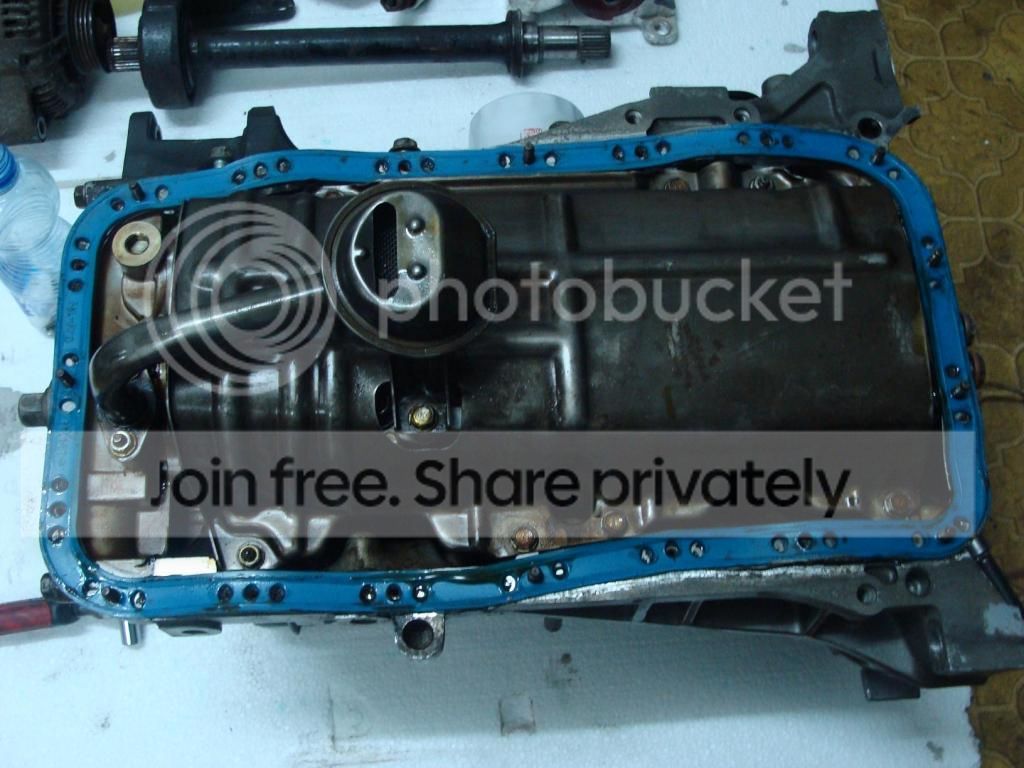

Fel Pro Gasket and Moroso Racing Oil Pan

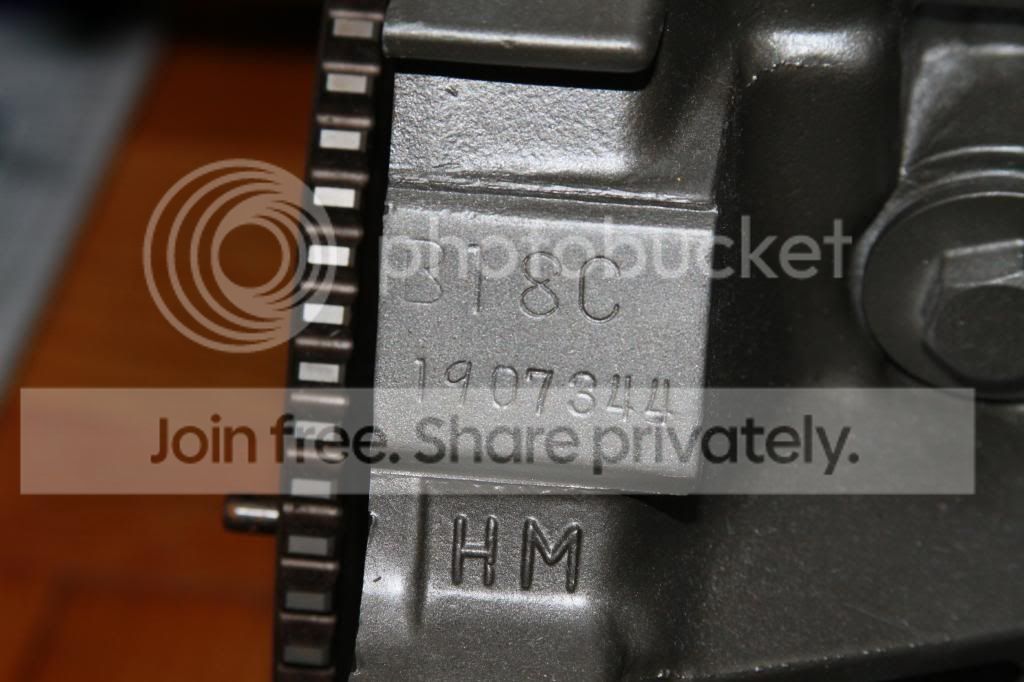

JDM R Crankcase sign

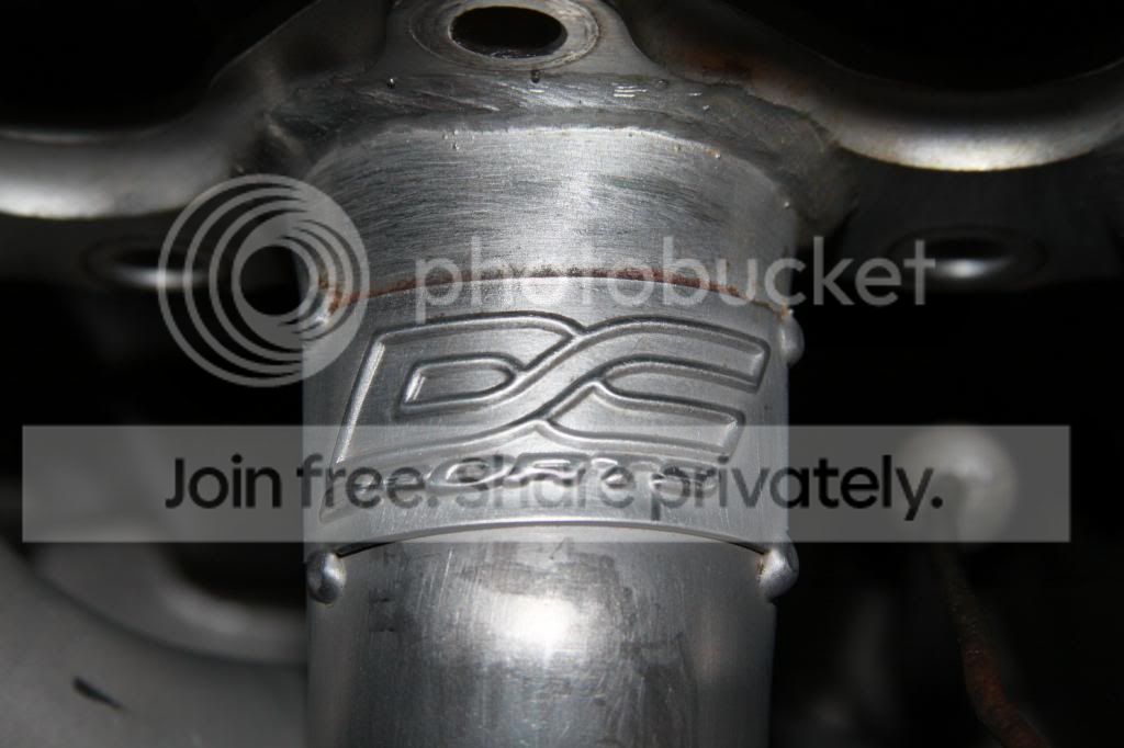

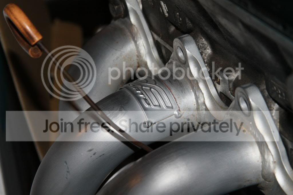

DC 4-2-1 Ceramic Coated Header

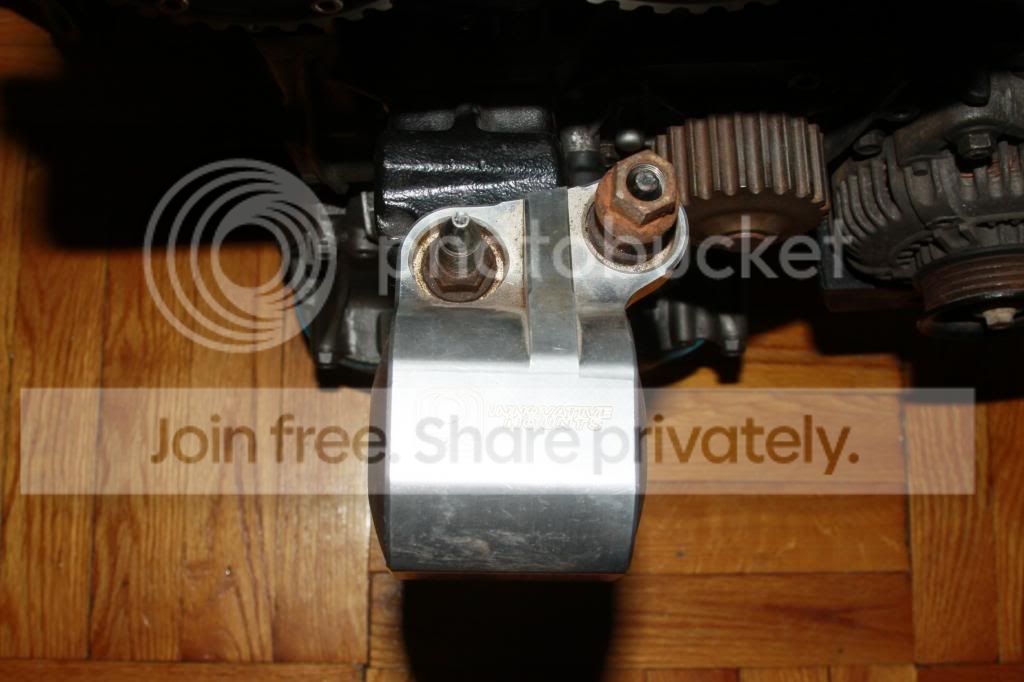

Innovative Engine Mounts

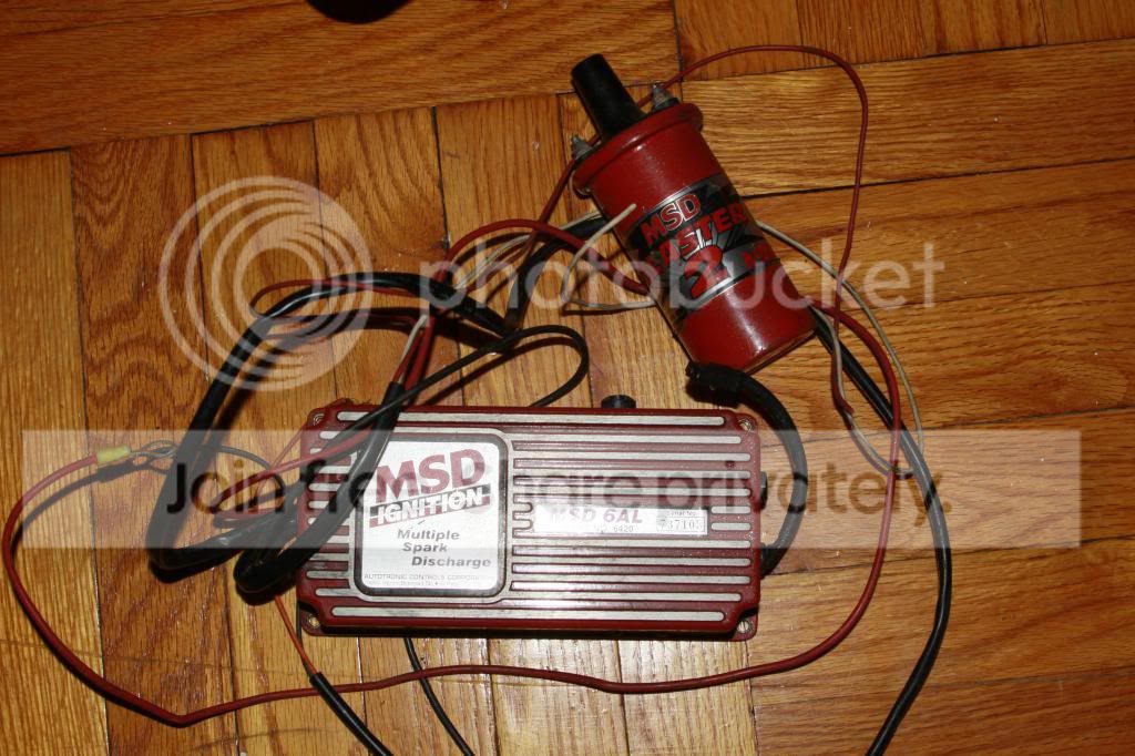

Msd Igniton + 10 mm Cables
Gearbox intermediate shaft
New Timing Belt with tensioner
etc

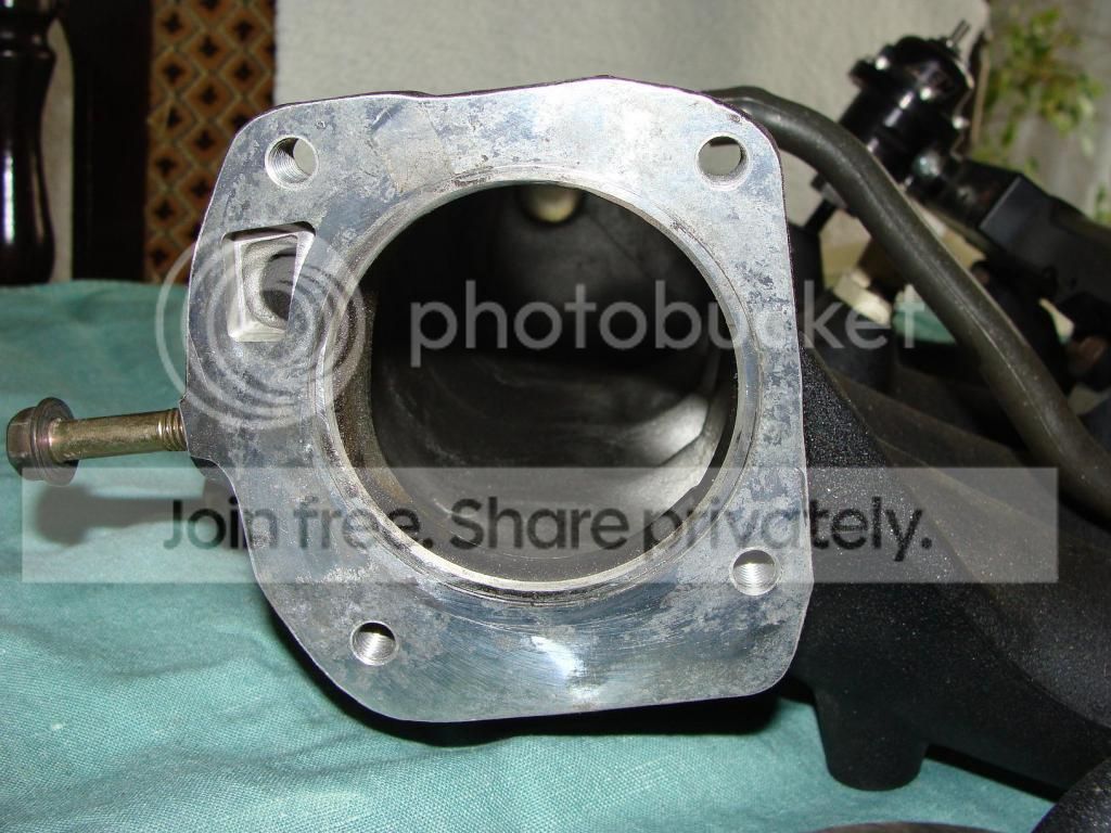

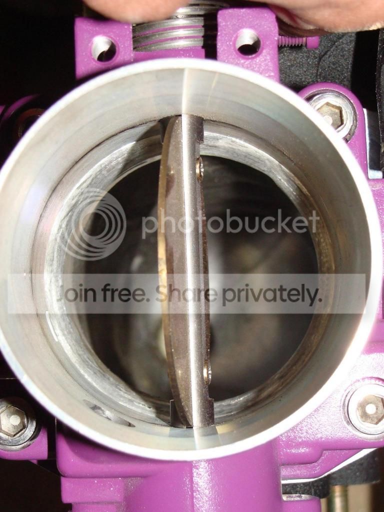

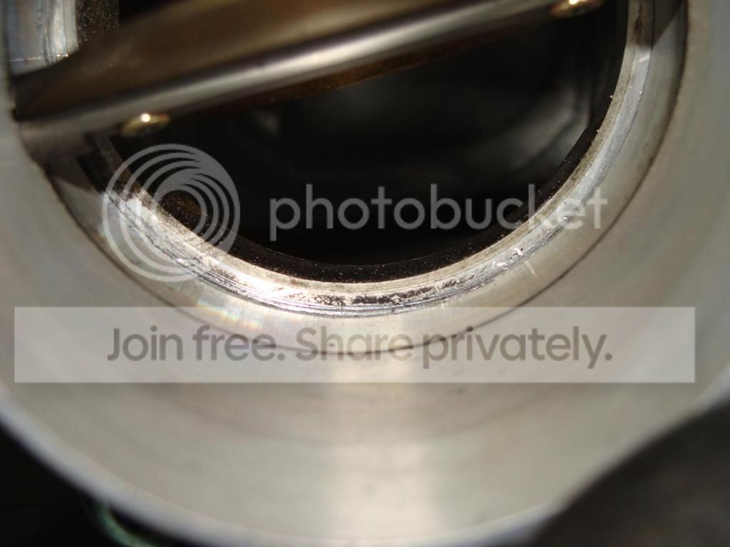

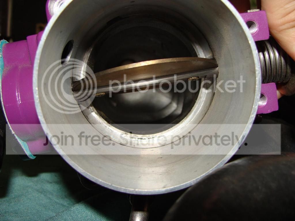

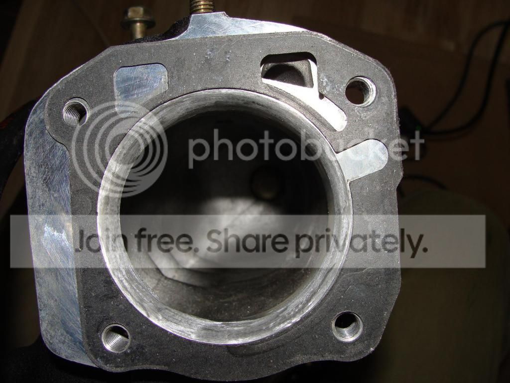

Throttle Body Port-Matching 2mm in each side

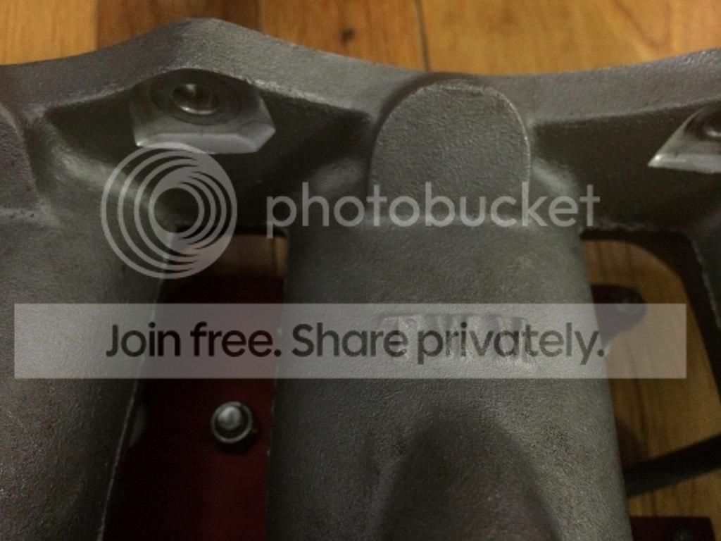

Skunk2 Pro Intake manifold 64mm port maching with 70MM Skunk2 Throttle body

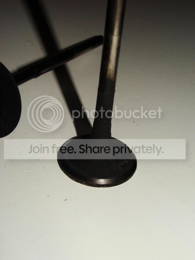

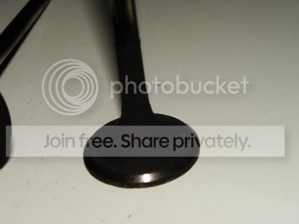

Cleaning Valves
Thanks For Watching

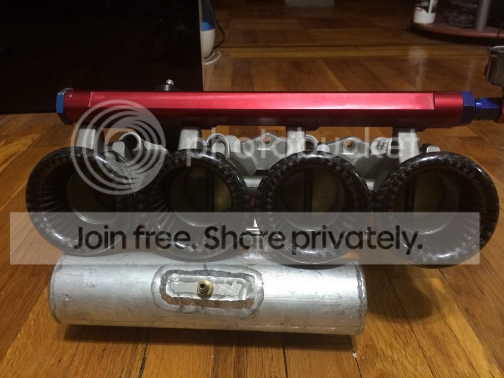

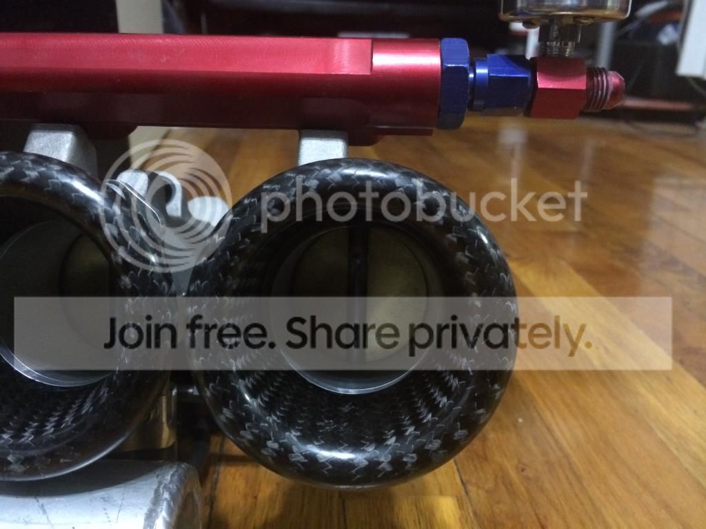

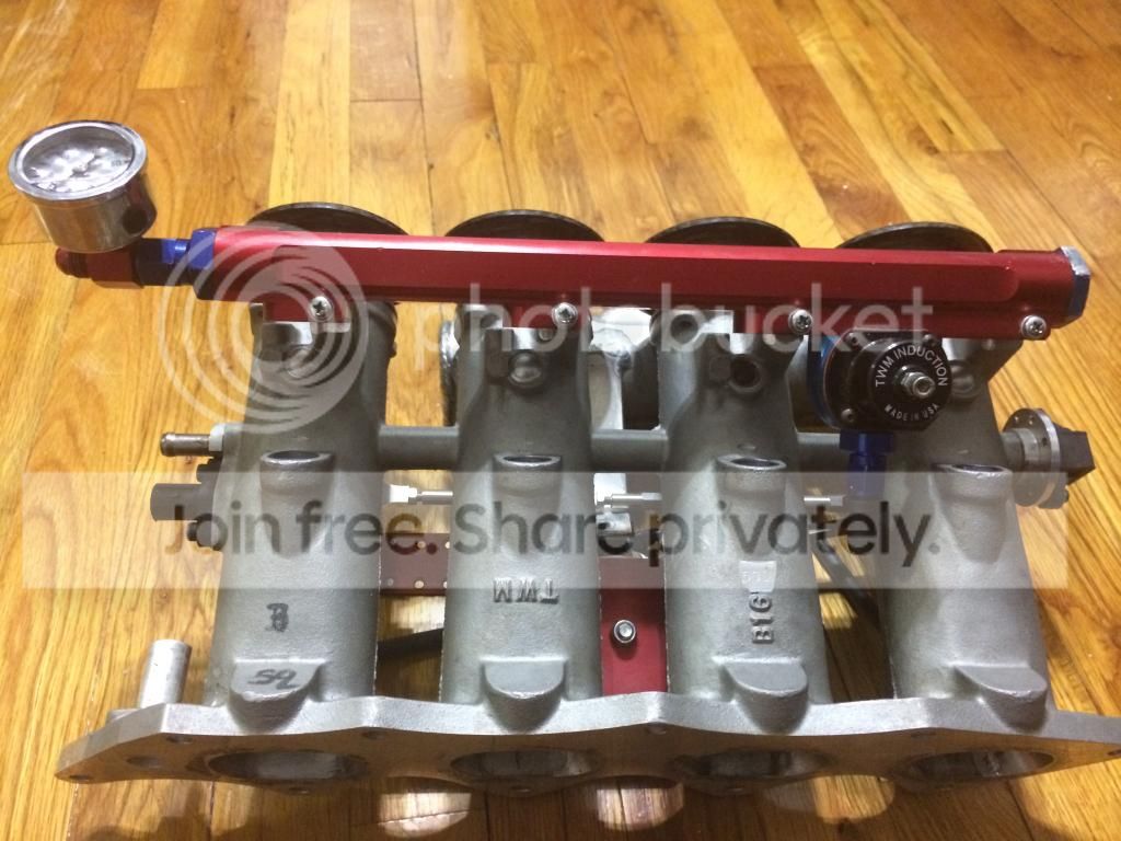

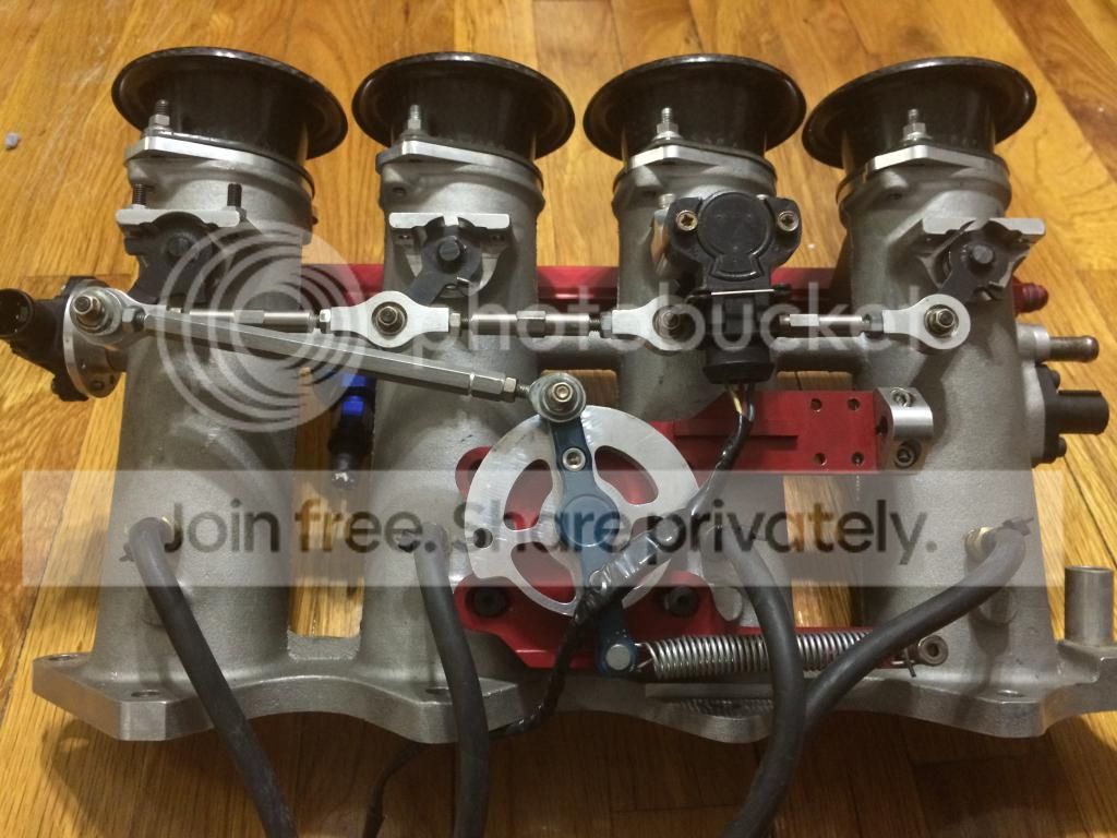

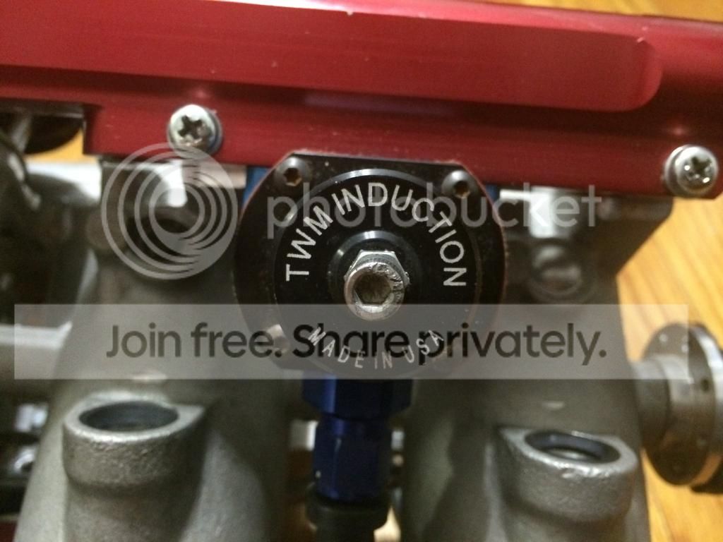

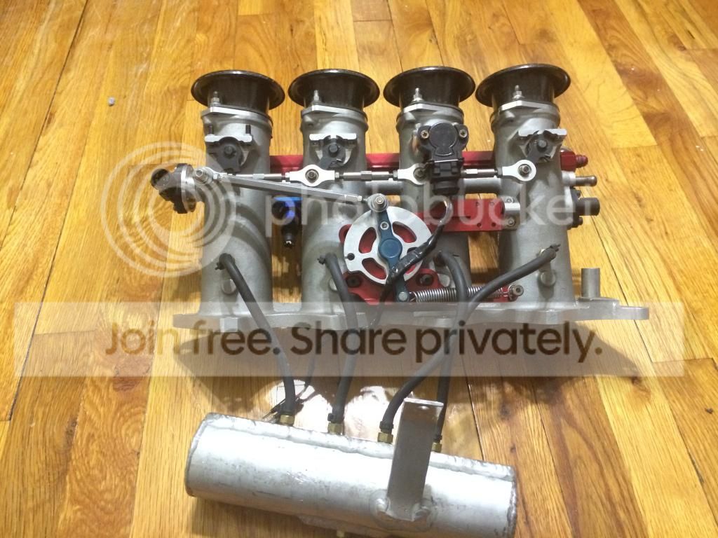

New Valve seals

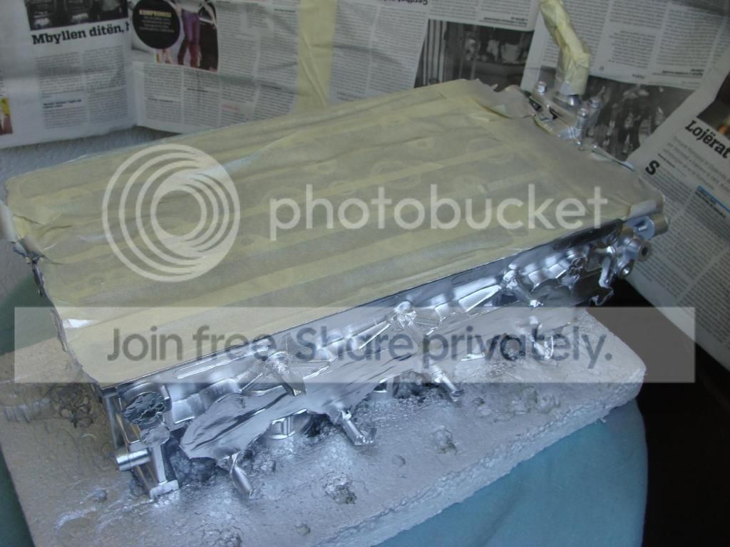

and TWM ITB 52mm Air Horn Carbon complete with fuel rail ,fuel regulator ,fuel pressure regulator,vacuu lines, map sensor ,tps sensor ,air sensor
some polishing job
[img][/img]
[img][/img]
[img][/img]
[img][/img]

PříspěvekZaslal: 18.2.2015 , 18:58   Citovat
Nice ITB, but are you sure that 52 mm is good diameter for fine tuning on your 1.8 engine? 52 mm is maybe acceptable for hardcore high HP projects I think and some guys had issues with this kind of big diameter - it makes low velocity speed in plenum and kill advantages of ITB's - good midrange and fast response
Příspěvky: 1842 H+ body: 7 1992 Civic
PříspěvekZaslal: 18.2.2015 , 19:03   Citovat
@Space Man :im between crx and civic ej9
@Street Kid : Its going to be semi build all motor with skunk2 head package and hi comp pistons
