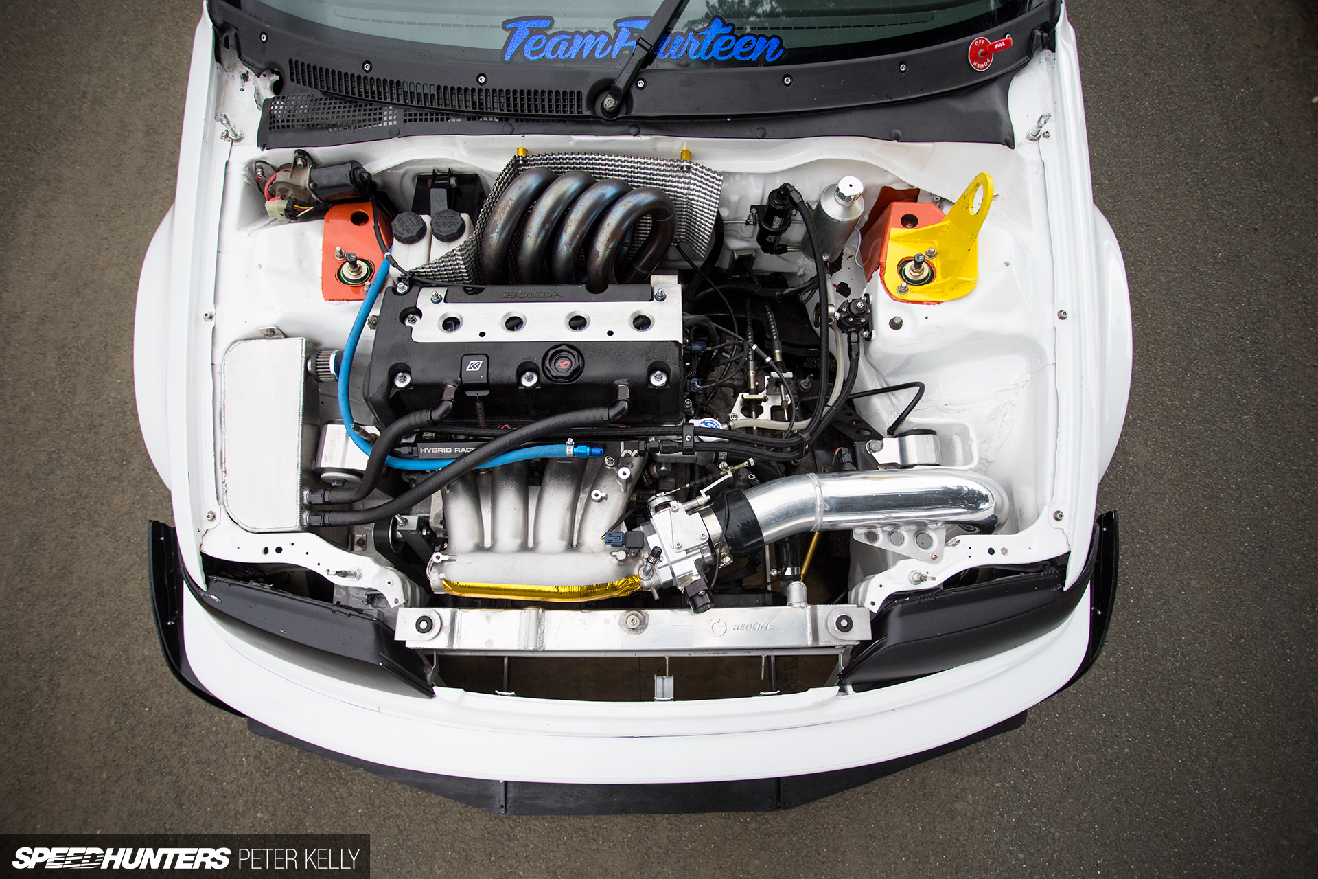

nevim kam s tim, ale tenhle build se mi libi... VTEC
K20A-Powered 1988 Honda Civic EF3
www.speedhunters.com
AM7I9417.jpg, 1.33 MB
